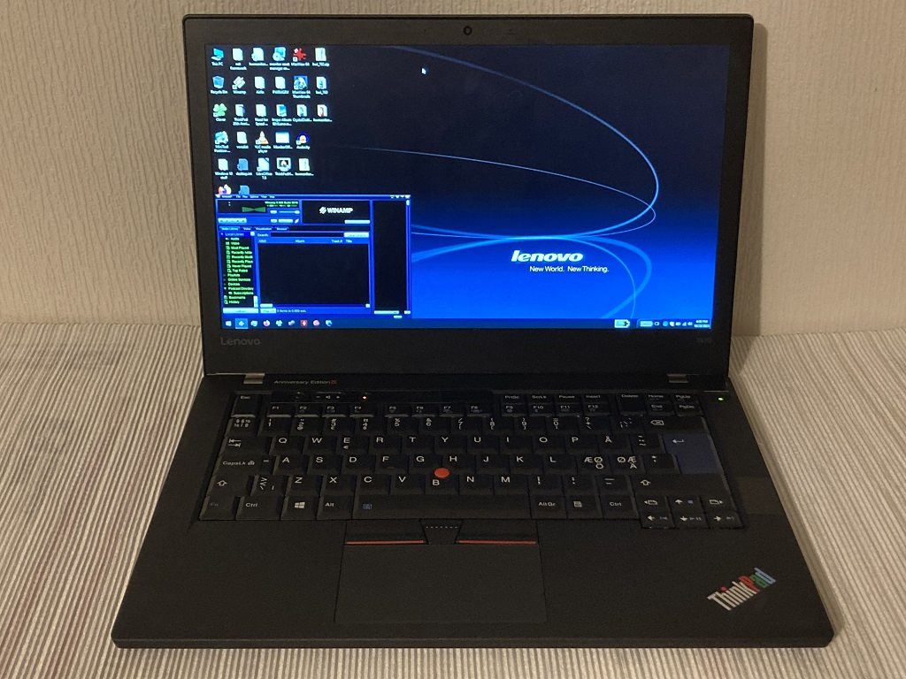

Finally feeling confident to share visuals of my final product. It's not a real T25, it's not perfect, but I built it and it's mine and I love it.
https://i.postimg.cc/63H5JXd2/IMG-3045a.jpg
Figure A: My one-of-a-kind Venticinque, sporting a modest i5-7300U, 24GB RAM, B140HAN01.1 1920x1080, and PM991 256GB. Truly this is nothing more than the standard secondhand ex-corporate T470 with enough 25th Anniversary bits to make it meaningful to me as a classic ThinkPad enthusiast.
https://i.postimg.cc/XqpNnz82/IMG-3048a.jpg

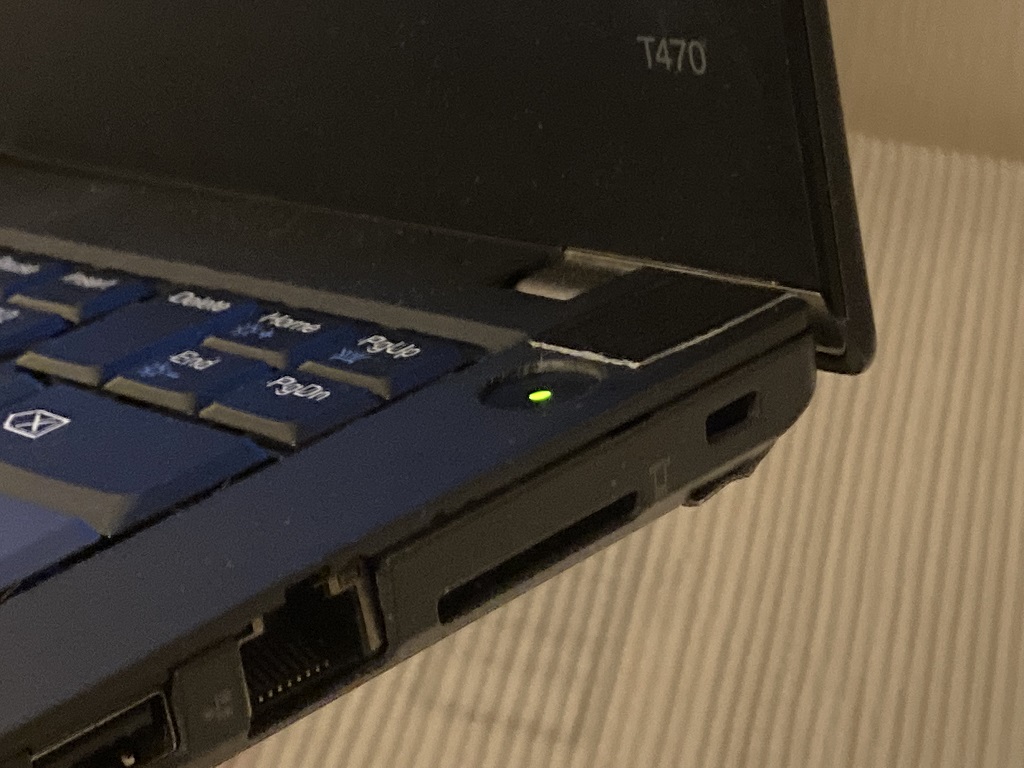

Figure B: The unobtanium-status of the 01HX688/01AV232 Power Button Cable required me to improvise. I decided to surgically transplant the original T470 power button and its corresponding magnesium corner into the T25 palmrest. The result fails to properly pop together so acted like a doorstop against closing the lid. Rather than endure additional disassembly and reassembly of the laptop to finesse the fit, I found a janky but effective solution in gorilla tape that is acceptable to me and that's all that matters. The laptop does not pop apart when opening/closing the lid.

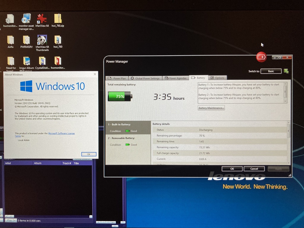

Figure C: Unblocked Power Manager 6 is properly handling charge thresholds on both OEM batteries. I'll keep my conspiratorial conjecture about Vantage to myself today. But I favor Power Manager.
Heh. I dropped my corporate TP25 on its rear left corner a couple of years ago, and the plastic broke, leaving a gap. I used plain black electric tape to seal it shut, it kinda looks okay, and I only had to replace it once or twice. Maybe gorilla tape is better. But the electric tape is nearly invisible, so that's a plus for me...
Me too. Maybe I should consider 'unblock' Power Manager on all my Win10 Thinkpads. Where are the instructions? Does everything work including power schemes / hot keys?

I follow the instructions from this thread: https://forum.thinkpads.com/viewtopic.php?f=73&t=131019, linking to this Microsoft forums thread: https://answers.microsoft.com/en-us/win ... 16d34b3f3b
wmfan_somebody_stole _my_screen_name wrote:had the same problem after upgrading to build 10586, but there are always smart people out there. (credit goes to KeyboardOverMouse's post on https://www.reddit.com/r/Windows10/comm ... annot_run/), basically you need to do the following:
1. get the latest power manager from Lenovo website
2. run the downloaded file, it will fail saying " ... doesn't work on this version of Windows ..." or similar
3. go to C:\DRIVERS\VISTA\PWRMGRV and change setup.exe compatibility mode to windows 7
4. go to https://msdn.microsoft.com/en-US/window ... x#adkwin10 and download "Windows ADK for Windows 10, Version 1511"
5. run it and you only need to install "compatibility administrator"
6. run "compatibility administrator", on the left, under System Database->Applications, click "Lenovo Power Manager"
7. on the right, right mouse click setup.exe and select "disable entry"
8. now you are on the way installing and using power manager
good luck!
For step 4. I've used Windows ADK for version 2004. When installing I uncheck everything and check the first box "Application Compatibility Tools".
Unfortunately Power Manager is not fully functional. If Vantage is already installed working fine, I would retain Vantage (as is the case with my P71).

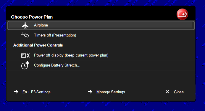

Regarding hotkeys: My Fn+F3 does nothing on this DIY-T25, I think because I don't have Vantage installed. On the true classics, with Hotkey Features functioning, Fn+F3 properly opens the Power Scheme selector. On the classics, Functional Hotkey Features is more reliant on the old vcredists being installed and the particular version of Hotkey Features (3.81) being installed. Then 7-row-swapped **30s, and this DIY-T25, work better with the newer Hotkey Features.
Regarding Power Schemes: The only Power Schemes that install for me with Win 10 are Airplane and Timers off. The various others (Power Source Optimized, Max Performance, etc.) are MIA. I find the built-in Windows version of customizing the power scheme under "Control Panel\Hardware and Sound\Power Options\Edit Plan Settings" is an effective substitute.

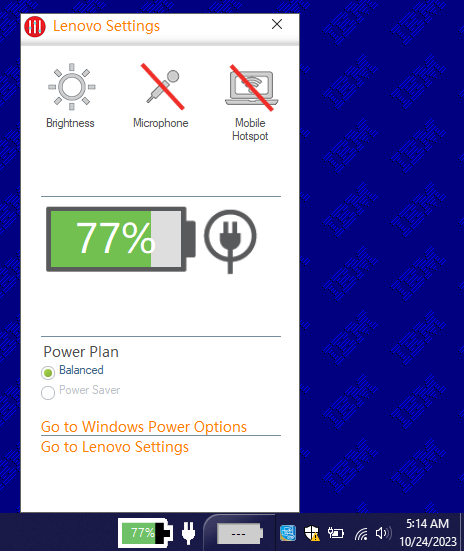

One can download and install the simple bg10ww23.exe "Lenovo Battery Gauge" toolbar to get a simple battery gauge. https://download.lenovo.com/consumer/mo ... 10ww23.exe
Clicking on it opens up this popup menu:
The shortcut to Windows Power Options links to "Control Panel\Hardware and Sound\Power Options". The shortcut to Lenovo Settings opens an annoying box to the Windows Store, pressing Esc clears it.
Newer versions of the Battery Gauge exist and can be downloaded by increasing the last integer in the filename in the download.lenovo link, but I don't find they improve anything and the final versions come with Settings/Vantage bloat worked in. Conversely earlier versions don't have the popup menu.
Oh, I love this one. I use it on Win8.1 on this X220 I'm typing from right now. Got the whole Lenovo Settings (pre-Vantage) installed here. Strangely, the "Go to Lenovo Settings" link does not work, but opening it manually does.
